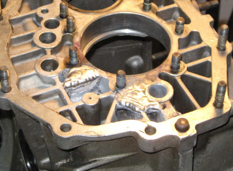

Wanted to inform you that we engineered and milled further different bearing supports for the later 915 gearboxes with aluminium case. For this gearbox the bearing supports from the old 916 kit from the 70s don´t fit. We had to find a way to fix these supports in the gearbox as the later 915 does not have the three casted positions where you can cut threads to fix this support. Will make further pictures at short notice to show you details and supply them here.
Martin

bugat5speed   Hi together, we made the first two conversions wi...   Apr 26 2010, 01:42 AM

bugat5speed   Sorry Chris, if we had talked about it it would n...   Apr 26 2010, 12:55 PM
Racer Chris   I sent one email before beginning the alterations ...   Apr 26 2010, 07:03 PM

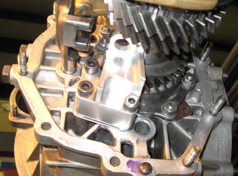

bugat5speed   Hi Chris and all of you, here are first picture...   Apr 28 2010, 12:59 PM
bugat5speed   another picture:   Apr 28 2010, 01:02 PM

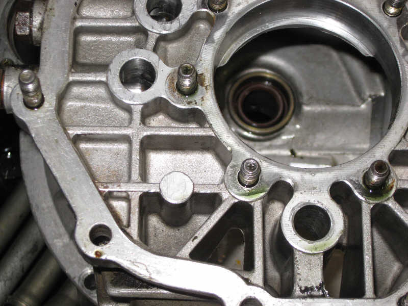

bugat5speed   more pictures instead of explanations (sometimes n...   May 3 2010, 12:35 PM
bugat5speed   and another one:   May 3 2010, 12:36 PM
turboman808   HAHA That would have made it easier. Everything ...   May 3 2010, 12:38 PM
bugat5speed   Hi turboman808, nice to hear that it´s working f...   May 4 2010, 01:04 AM
