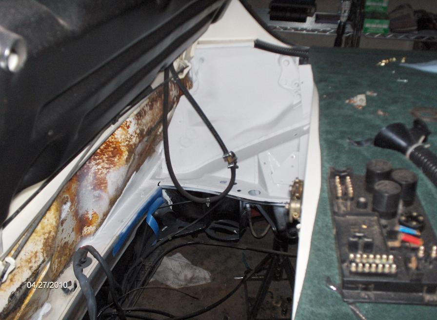

Since everything over on this side was so solid and only a section was hacked out of the shelf for the AC, I opted to graft in just the part that was cut out. I sourced the weatherstrip rail from Rich and built my own little metal shelf section. Welded, painted, done. That took hours to do.
I didn't weld up the two holes for the AC lines, just found some metal "plugs" at a local hardware store and they snapped into place. Why bother with anything else right now. It'll keep the road grime out of the engine bay.

Root_Werks   Progress seems slow, but thanks to local guy (Rich...   Apr 27 2010, 08:43 AM
Root_Werks   Since everything over on this side was so solid an...   Apr 27 2010, 08:47 AM
Root_Werks   Also cleaned up both longs, door jams and all weat...   Apr 27 2010, 08:52 AM
