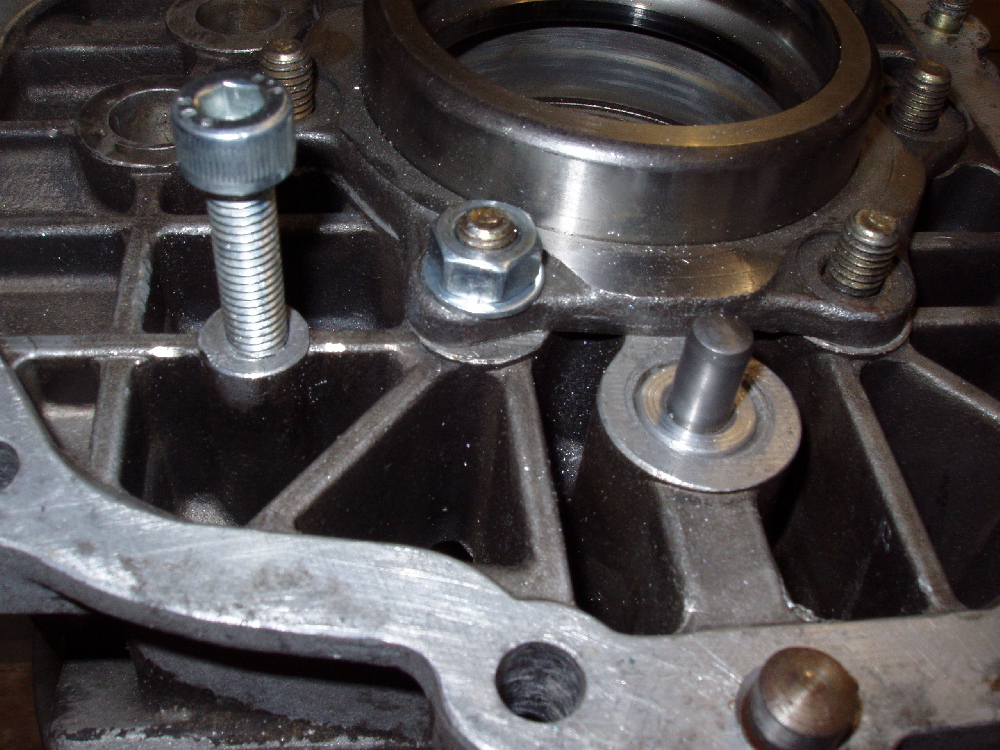

bugat5speed   Hi together, we made the first two conversions wi...   Apr 26 2010, 01:42 AM
Racer Chris   Hi together, we made the first two conversions w...   Apr 26 2010, 11:00 AM
bugat5speed   Sorry Chris, if we had talked about it it would n...   Apr 26 2010, 12:55 PM
Racer Chris   I sent one email before beginning the alterations ...   Apr 26 2010, 07:03 PM
bugat5speed   Hi Chris and all of you, here are first picture...   Apr 28 2010, 12:59 PM
bugat5speed   another picture:   Apr 28 2010, 01:02 PM
bugat5speed   more pictures instead of explanations (sometimes n...   May 3 2010, 12:35 PM
bugat5speed   and another one:   May 3 2010, 12:36 PM
