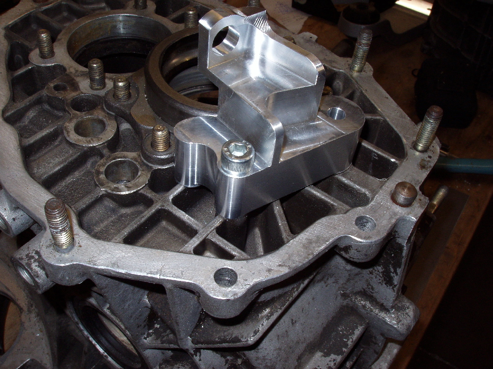

bugat5speed   Hi altogether, am nearly finnished now with all p...   Mar 14 2010, 03:33 AM

bugat5speed   here are the new bearing supports made from billet...   Mar 14 2010, 12:29 PM
