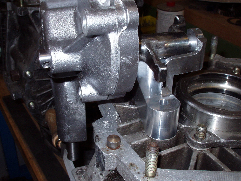

Attached another pic with the shift mechanism.
Martin

bugat5speed   Hi Chris and all of you, here are first picture...   Apr 28 2010, 12:59 PM
bugat5speed   another picture:   Apr 28 2010, 01:02 PM
bugat5speed   more pictures instead of explanations (sometimes n...   May 3 2010, 12:35 PM
bugat5speed   and another one:   May 3 2010, 12:36 PM

bugat5speed   Hi turboman808, nice to hear that it´s working f...   May 4 2010, 01:04 AM
