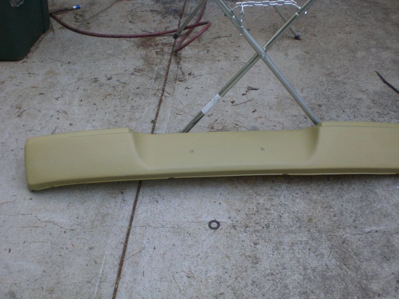

Cut the front bumper and set off the fire alarms getting all the bondo off that thing... I have a couple of other ideas for it.

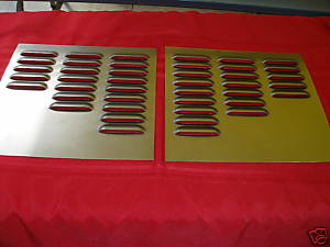

Smoothed and primered the rear bumper..
and looking at these for venting the hot air through my hood
