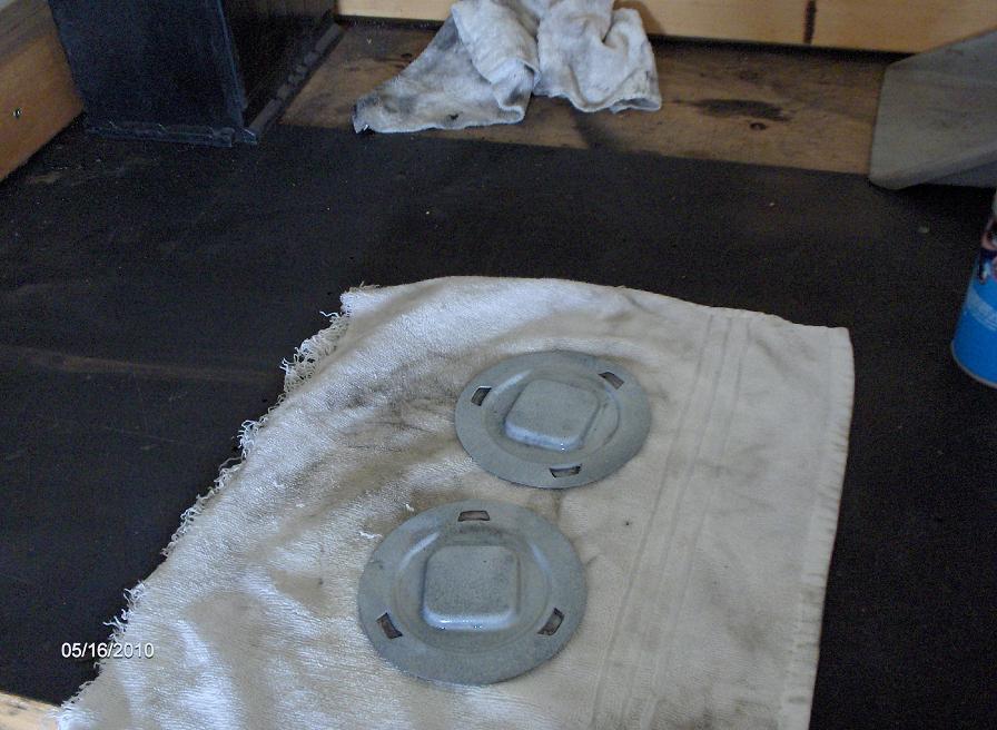

Root_Werks   I actually had two most excellent looking somewhat...   May 16 2010, 08:46 PM
Root_Werks   Trying to do this right, so I removed the body plu...   May 16 2010, 08:48 PM
Root_Werks   New section getting tac'd into place... :welde...   May 16 2010, 08:50 PM
Root_Werks   It may not look like it, but the whole floor is co...   May 16 2010, 08:53 PM
Root_Werks   I'll wait until tomorrow to install the plugs....   May 16 2010, 08:55 PM
Root_Werks   And in the middle of all this work, we still found...   May 16 2010, 08:59 PM
