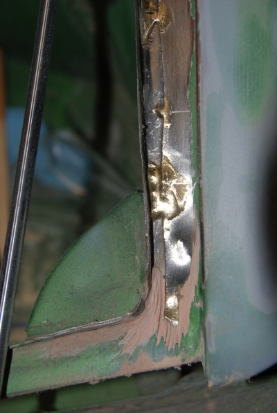

Got some minor body damage, not too bad, but i can see the right rear got a bit munched at one time. About 1/4" of bondo is coming off, and revealed some brazing. The lip around the inside corner is a bit too short to receive the rubber seal as it was always popping off there. I'm also removing a bunch of sillycone. Not quite sure how to fix this one. That lip needs about a 1/4" or so more height on it. Any thoughts?

swood   Got some minor body damage, not too bad, but i can...   May 18 2010, 09:48 PM

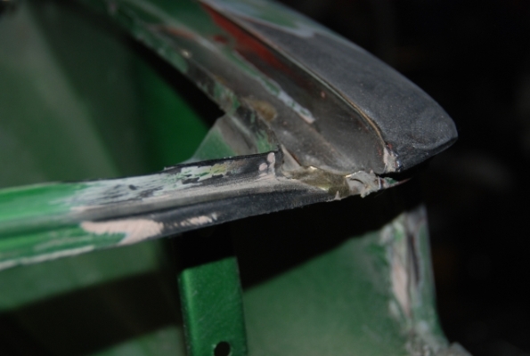

swood   Left side looks good. The right side has metal mis...   May 18 2010, 09:49 PM
KaptKaos   And you are??? :lol:   May 19 2010, 01:05 AM
swood   Just a guy looking for a little help... :chair: ...   May 19 2010, 10:45 AM
Aaron Cox   Just a guy looking for a little help... :chair: ...   May 19 2010, 12:24 PM
swood   Just a guy looking for a little help... :chair:...   May 19 2010, 03:29 PM
