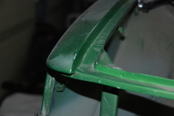

swood   Got some minor body damage, not too bad, but i can...   May 18 2010, 09:48 PM
swood   Left side looks good. The right side has metal mis...   May 18 2010, 09:49 PM
