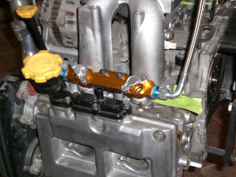

Bought the pcv breathing set up,, bypass feeding back into intake.
lighter crank pulley
Going the circle track shop on Mon to if they have some coil overs for my koni reds and any deals on brakes.. They are getting out of that business.. Cash discounts!!
JDM spec fuel rail for side feed injectors, a little bling and a little simplifing the fuel system...besides I like -6 vs hose clamps,, I'll have one out back and two upfront.. My breakpoints will be -6.

Nice oil filler cap.... (IMG:style_emoticons/default/rolleyes.gif)
