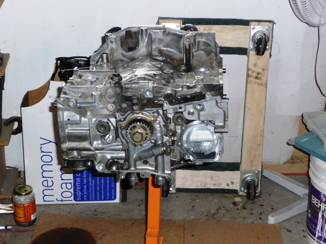

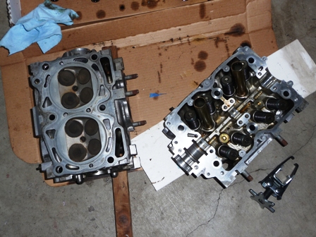

I stripped the Suby down to a short block and gave it the once over!
- New gaskets, new water pump, new time belt and pulleys, new Delta Cams (1000 grind), valves reseated and rockers gapped, and the cylinder heads were cleaned up, gasket matched, and polished up! (IMG:style_emoticons/default/smilie_pokal.gif)

Short block cleaned up
Cylinder heads awaiting tear down.
