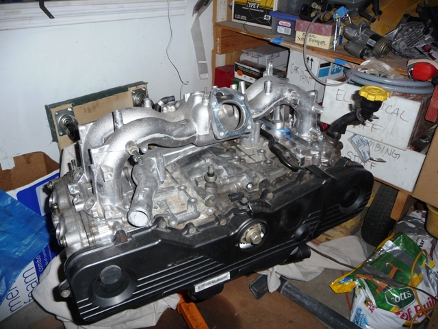

Longblock assembled after reading over the Suby Tech Manual for awhile...

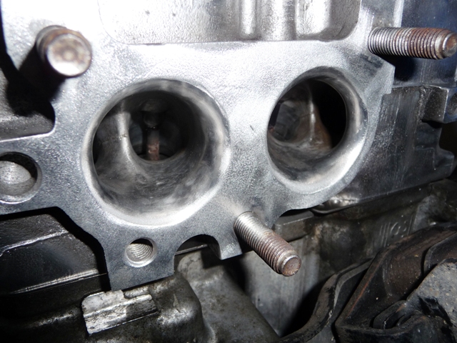

Zaney   Drove down to Tacoma where I stopped by Delta Cams...   May 24 2010, 11:37 PM
Zaney   Exhaust side Longblock assembled after reading ...   May 24 2010, 11:40 PM
