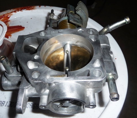

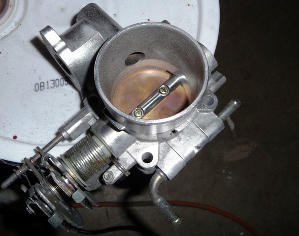

Throttle body cleaned up using a homemade soda-blaster siphon gun!

Zaney   Throttle body cleaned up using a homemade soda-bla...   May 24 2010, 11:42 PM
