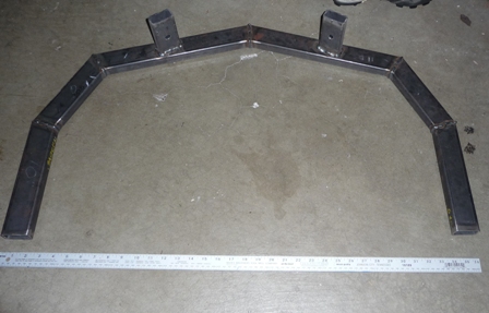

Strawman version of the Suby engine mount bar. Inspired from S. Thatcher and Tony!

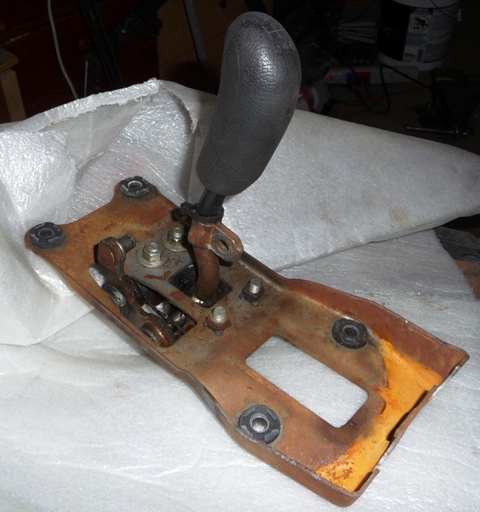

MR2 Shifter ready to be cleaned up and mocked up!

Zaney   Strawman version of the Suby engine mount bar. In...   May 24 2010, 11:45 PM

strawman   Lookin' good! :beer3: You might want to...   May 25 2010, 06:20 PM
