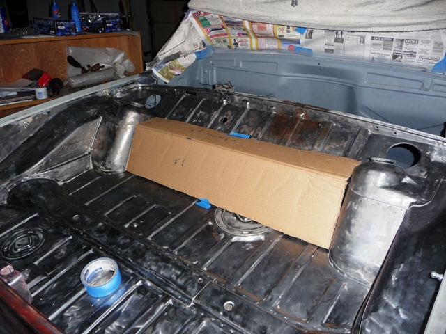

Rear firewall trunk area cleaned up and ready to be (IMG:style_emoticons/default/sawzall-smiley.gif) and (IMG:style_emoticons/default/welder.gif) !!!

Zaney   Rear firewall trunk area cleaned up and ready to b...   May 24 2010, 11:47 PM
Zaney   Next step after the firewall is fabbed up is to lo...   May 24 2010, 11:51 PM

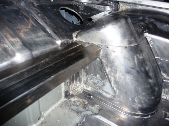

Zaney   Thought I would listen to Geoff's advice and t...   May 31 2010, 12:25 AM
Zaney   tied all the gusset plates together into the ...   May 31 2010, 12:29 AM
Zaney   Followed the advice of many who have come before m...   May 31 2010, 12:33 AM
