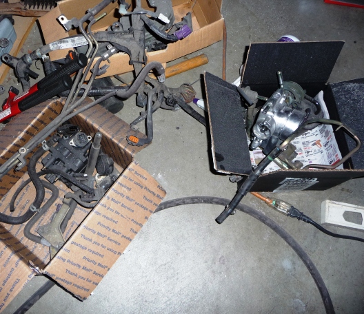

Next step after the firewall is fabbed up is to locate the final resting position for the powerplant and make the tranny mount.
Also, sort out the FI mess (IMG:style_emoticons/default/chair.gif)

Zaney   Throttle body cleaned up using a homemade soda-bla...   May 24 2010, 11:42 PM
