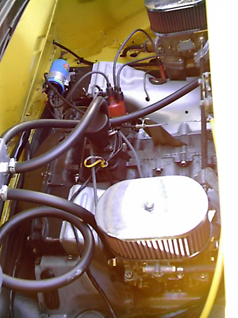

Okay so I am putting a nice set of dual weber 40's on the LE. Going to get my break in miles done & drive it while I work on the FI stuff on the side. I get the basics of how to get them on. Was hoping someone could give me a nice step by step so I don't miss anything. Or put it on in the wrong order. I got the complete setup from Rich & he included everything needed except linkage which I picked up.
I allready installed the distributor & the intakes. I know I need to get my car to TDC & make sure my firing order is right.
Okay lay it on me (IMG:style_emoticons/default/biggrin.gif) . In simple terms please (IMG:style_emoticons/default/blink.gif)

SirAndy   Here are pics That fuel pump is going to drive yo...   May 25 2010, 09:47 PM
JRust   Here are pics That fuel pump is going to drive y...   May 25 2010, 09:58 PM

sean_v8_914   this linkage set up is also common but not my favo...   May 26 2010, 09:50 AM

McMark   Sean, those drawings were you try to equalize ever...   May 26 2010, 10:34 AM
Vacca Rabite   :agree: I tried to draw it out the first time, an...   May 26 2010, 11:11 AM

sean_v8_914   not the measurements, just teh angles. its relativ...   May 27 2010, 03:19 PM
Root_Werks   These are good linkage pictures, what kind of link...   May 27 2010, 03:44 PM
Root_Werks   More of it, it's on my engine, haven't see...   May 27 2010, 03:46 PM
