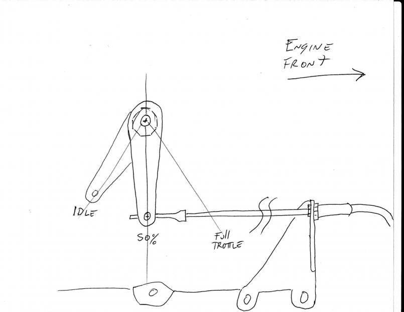

sean_v8_914   this linkage set up is also common but not my favo...   May 26 2010, 09:50 AM
sean_v8_914   dfrgfdgfd   May 26 2010, 09:53 AM
McMark   Sean, those drawings were you try to equalize ever...   May 26 2010, 10:34 AM

sean_v8_914   not the measurements, just teh angles. its relativ...   May 27 2010, 03:19 PM
