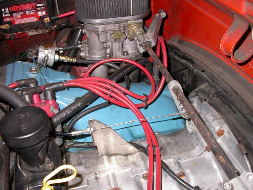

sean_v8_914   this linkage set up is also common but not my favo...   May 26 2010, 09:50 AM

McMark   Sean, those drawings were you try to equalize ever...   May 26 2010, 10:34 AM
Vacca Rabite   :agree: I tried to draw it out the first time, an...   May 26 2010, 11:11 AM

sean_v8_914   not the measurements, just teh angles. its relativ...   May 27 2010, 03:19 PM
Root_Werks   These are good linkage pictures, what kind of link...   May 27 2010, 03:44 PM
Root_Werks   More of it, it's on my engine, haven't see...   May 27 2010, 03:46 PM

biosurfer1   looks similar to the one I just setup and I agree,...   May 27 2010, 03:53 PM
Root_Werks   looks similar to the one I just setup and I agree...   May 28 2010, 09:18 AM

biosurfer1   Sean...can you take a picture of your return sprin...   May 28 2010, 12:17 PM
