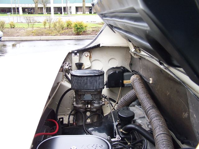

These are good linkage pictures, what kind of linkage is this?

Root_Werks   These are good linkage pictures, what kind of link...   May 27 2010, 03:44 PM
Root_Werks   More of it, it's on my engine, haven't see...   May 27 2010, 03:46 PM

biosurfer1   looks similar to the one I just setup and I agree,...   May 27 2010, 03:53 PM
Root_Werks   looks similar to the one I just setup and I agree...   May 28 2010, 09:18 AM
