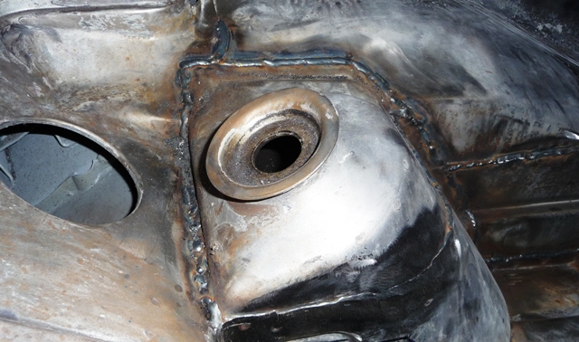

Thought I would listen to Geoff's advice and tighten up the welds in the trunk and the rear firewall before I cut into it.
Took about 3 hours of patiently seam welding and air quenching but it turned out alright. I ground off some of the high spots and the area between the strut towers for the new 'boxed out' firewall.
Then, measured and remeasured the trunk and... (IMG:style_emoticons/default/sawzall-smiley.gif)
Here are some pics to survey the surgery (IMG:style_emoticons/default/biggrin.gif)
Seam welded trunk
Got the firewall strut tower joint welded up
