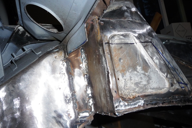

Followed the advice of many who have come before me and got to the inner seam weld between the firewall portions,
Now it is time to Fab up the 'box' and make it fit nicely in the Big Hole.
