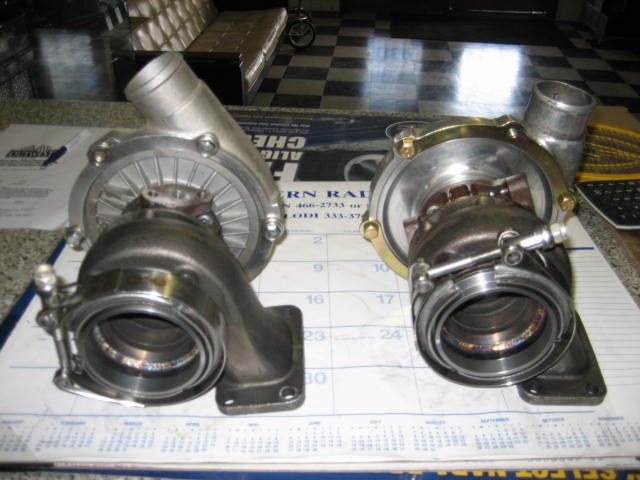

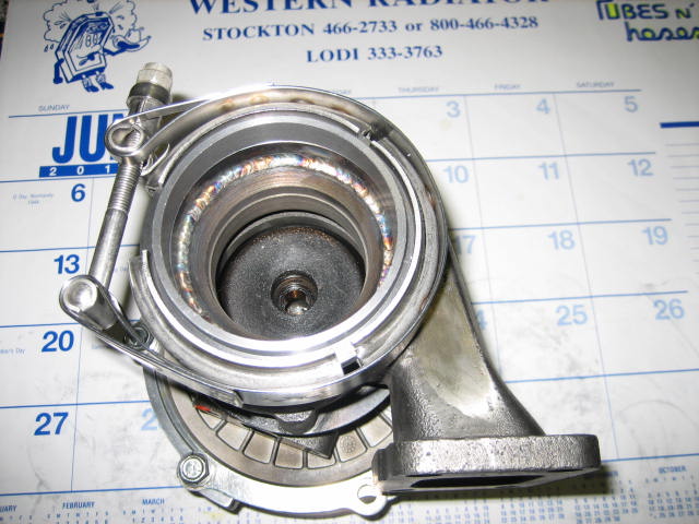

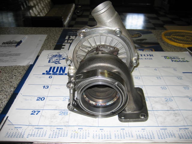

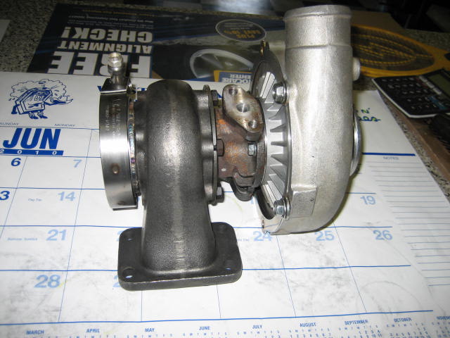

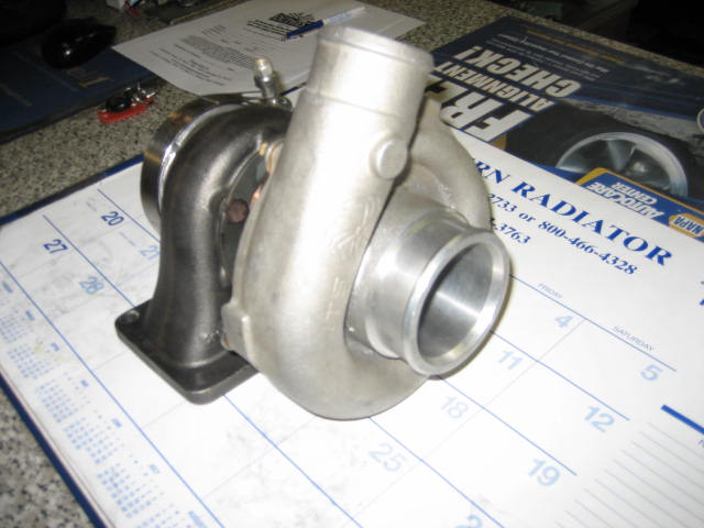

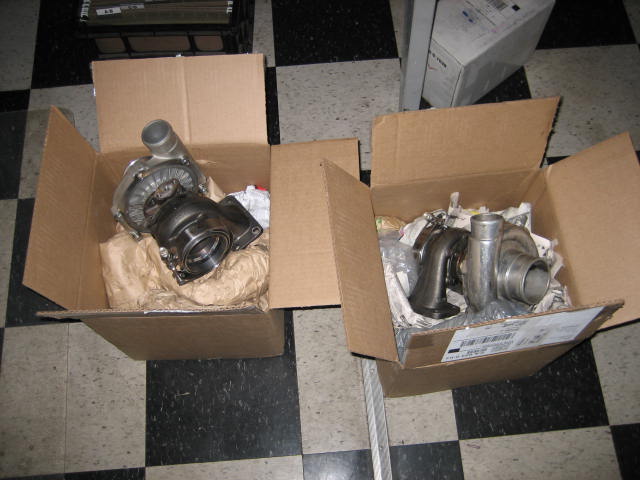

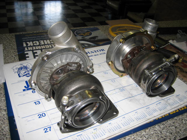

Well Cliff over at Turbo Power in Cameron Park came thru for me. I finally got my Mock up turbo's today. He set me up with some mock up center sections, and compressor housings, and I bought the exhaust housings. So now I can start to get going on the most integral part of my build. I ordered the inlet flanges, and transitions, and some tubing for my up-pipes from SPD exhaust, and I'll probably just pick up every thing on my way thru Sacramento next week. I'll post some more pics of my headers and turbos as I get them into the car.
(IMG:http://www.914world.com/bbs2/uploads_offsite/img.photobucket.com-752-1275598940.1.jpg)
(IMG:http://www.914world.com/bbs2/uploads_offsite/img.photobucket.com-752-1275598940.2.jpg)
(IMG:http://www.914world.com/bbs2/uploads_offsite/img.photobucket.com-752-1275598940.3.jpg)
(IMG:http://www.914world.com/bbs2/uploads_offsite/img.photobucket.com-752-1275598940.4.jpg)
(IMG:http://www.914world.com/bbs2/uploads_offsite/img.photobucket.com-752-1275598941.5.jpg)
(IMG:http://www.914world.com/bbs2/uploads_offsite/img.photobucket.com-752-1275598941.6.jpg)
(IMG:http://www.914world.com/bbs2/uploads_offsite/img.photobucket.com-752-1275598941.7.jpg)

TwinTurbo914   Not much of an update but, I haven't had much ...   May 12 2010, 12:07 PM
TwinTurbo914   Well Cliff over at Turbo Power in Cameron Park cam...   Jun 3 2010, 03:02 PM
charliew   So you eliminated the wastegate. How does this com...   Jun 4 2010, 08:41 AM
TwinTurbo914   These were not internal gated housings, and these ...   Jun 4 2010, 09:34 AM
charliew   You might want to make the jig a permanent fixture...   Jun 4 2010, 09:38 AM
