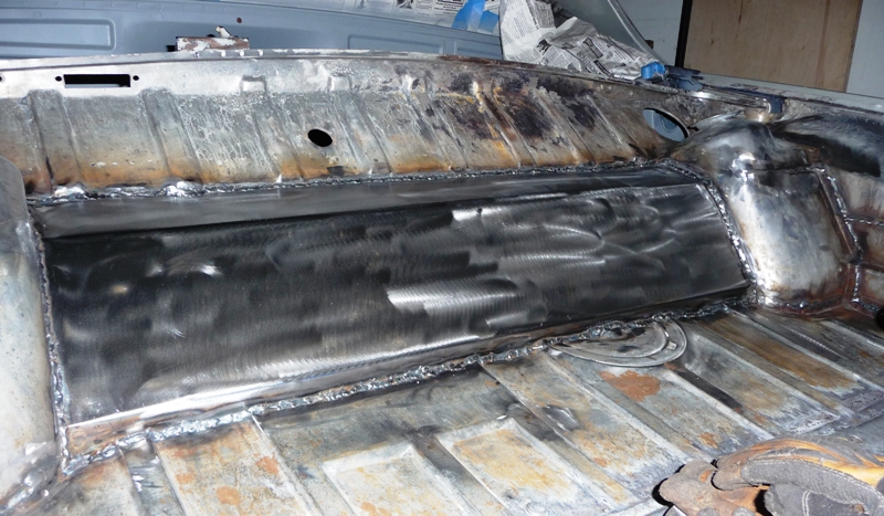

Got a bit of time thanks to Grandma visiting and watching Sydney for the day! Thank you Sue!!!
So, measured some 18 gauge sheet metal and buzzed it down to size! Took a spare 2'x4' and the table saw to rip out my form to bend the metal on. Then, found my cinder blocks and made my own DIY sheet metal brake. It got me close enough without a real one. (IMG:style_emoticons/default/huh.gif)
Followed Steve's (Porscharu) lead and braced the strut towers with a piece of 1 inch steel tubing. (IMG:style_emoticons/default/welder.gif)
Then, used the bench grinder to make the final tweeks on the firewall cover.

Zaney   It has been a while since an update but, progress ...   Mar 7 2010, 12:46 AM
Zaney   Pic of interior firewall Engine bay firewall   Mar 7 2010, 12:48 AM
Zaney   Hell hole ready for seam sealer and 2K Primer. 16...   Mar 7 2010, 12:50 AM
Zaney   And the trunk firewall before being boxed out for ...   Mar 7 2010, 12:58 AM

Zaney   Rear firewall trunk area cleaned up and ready to b...   May 24 2010, 11:47 PM
Zaney   Next step after the firewall is fabbed up is to lo...   May 24 2010, 11:51 PM
