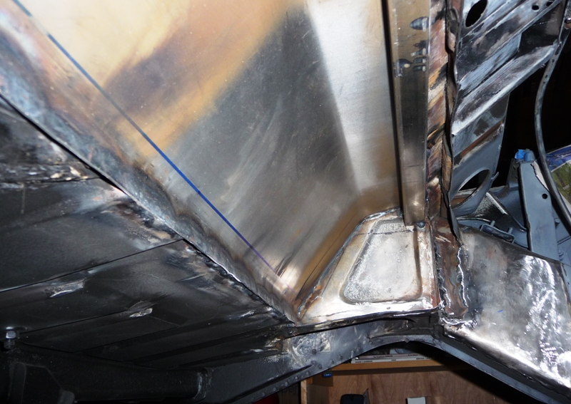

Looking up from the engine bay "new expansion"! (IMG:style_emoticons/default/beer.gif)

Zaney   Got a bit of time thanks to Grandma visiting and w...   Jun 5 2010, 10:57 PM
Zaney   Looking up from the engine bay "new expansion...   Jun 5 2010, 10:59 PM
