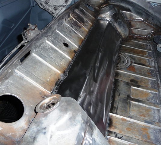

Zaney   And the trunk firewall before being boxed out for ...   Mar 7 2010, 12:58 AM

Zaney   Rear firewall trunk area cleaned up and ready to b...   May 24 2010, 11:47 PM
Zaney   Next step after the firewall is fabbed up is to lo...   May 24 2010, 11:51 PM
strawman   Lookin' good! :beer3: You might want to...   May 25 2010, 06:20 PM
