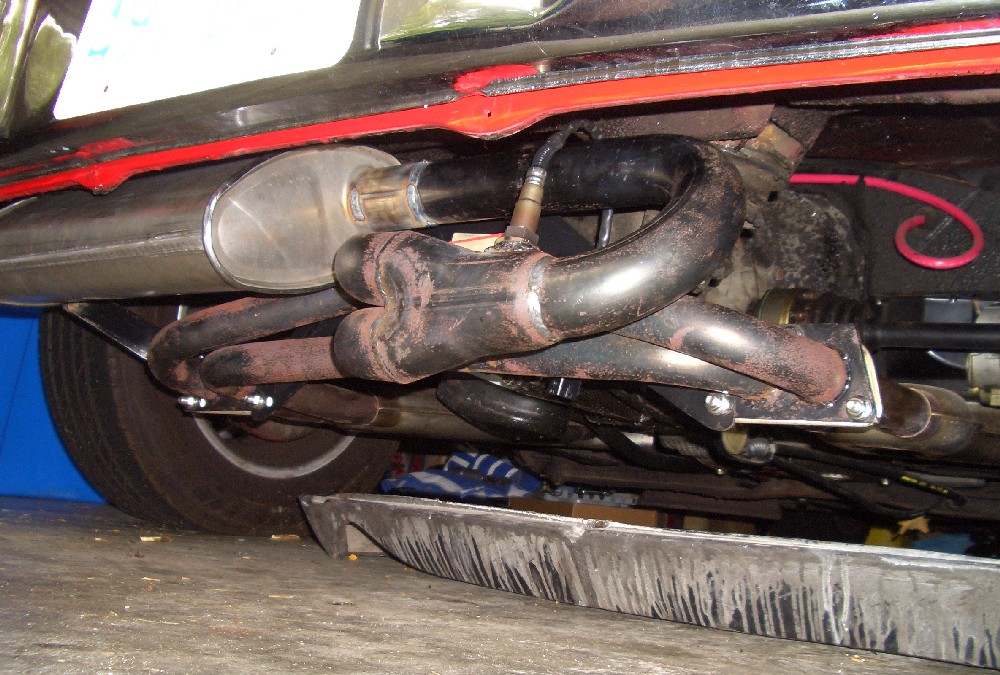

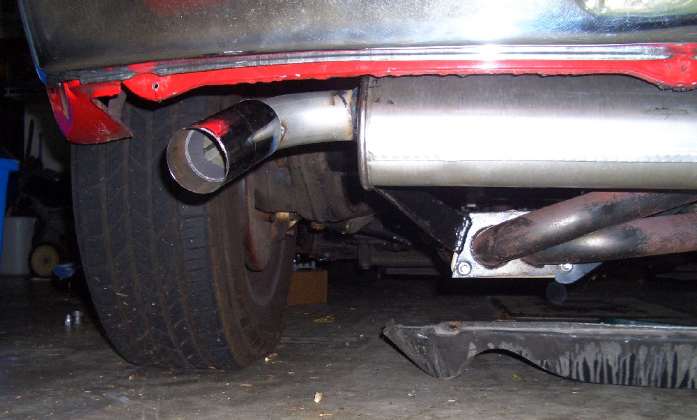

Making some progress. I sawed off the tailpipe, just upstream from the tack weld, cut it shorter (where it goes into the muffler), and shoved it in further. This aligned it with the notch in the valance. (per Azbill's earlier suggestion). Took it in for the final weld, including attaching the bung for the O2 sensor.
I'm holding off on painting it. I'm thinking that at the end of the season, I'll have it blasted and maybe go the jet-hot coating route. I'll have to ship it somewhere to be done (no outlets around here), but at the end of the season, that'll work.
Note how the original reinforcement brace from the inlet flange mates to the new muffler. Also note the original Bursch tailpipe.
Installed pics below. A few more in the follow on post.
Jim
