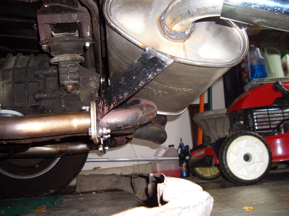

jk76.914   OK. It fits. It needed a minor distortion, which...   May 22 2010, 04:07 PM

jk76.914   Got it tack welded. Took about 10 minutes, and he...   May 24 2010, 06:52 AM
azbill   Suggestion put the valance on to make sure the tai...   May 24 2010, 10:12 AM
jk76.914   Suggestion put the valance on to make sure the ta...   May 24 2010, 03:37 PM

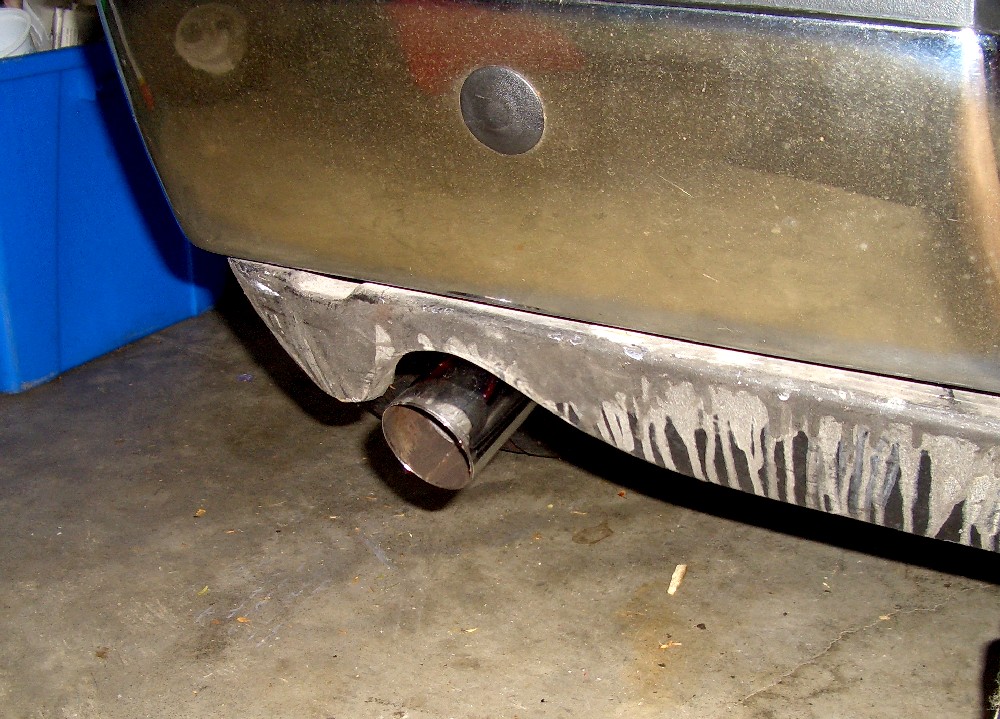

jk76.914   Making some progress. I sawed off the tailpipe, j...   Jun 13 2010, 01:23 PM
jk76.914   RE: Walker 22430 Quiet-FlowSS stainless muffler.   Jun 13 2010, 01:27 PM
Andyrew   Honestly I would just give it some rattlecan high ...   Jun 13 2010, 10:50 PM
