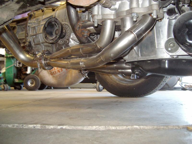

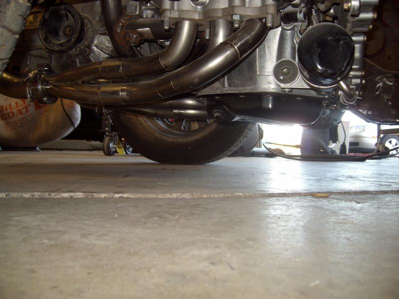

As promised here are some pics of the progress, one header is built, just have to final fit it, and weld it up and install a v-band on the outlet for my up pipe, and fit and weld my double slip fittings on the collector tubes. The right side is going to be a mirror image of it, just waiting on some more tube to build it. And the turbo's are hung in the engine bay temporarily, until I make the support brackets to help support there weight, then i'll build my up-pipes to them. Ill post more pics as I make more progress.

I got a lot of work done on the car this weekend, built my passenger side header, and got both sides all tacked together. And then started on the outlet pipes of the turbo's, got my x-pipe built and just have to fit a few more pieces of tube and the outlets will be done. Just waiting on my flanges, transitions and v-bands for my up-pipes, which I will be getting today. So things are really starting to come together.

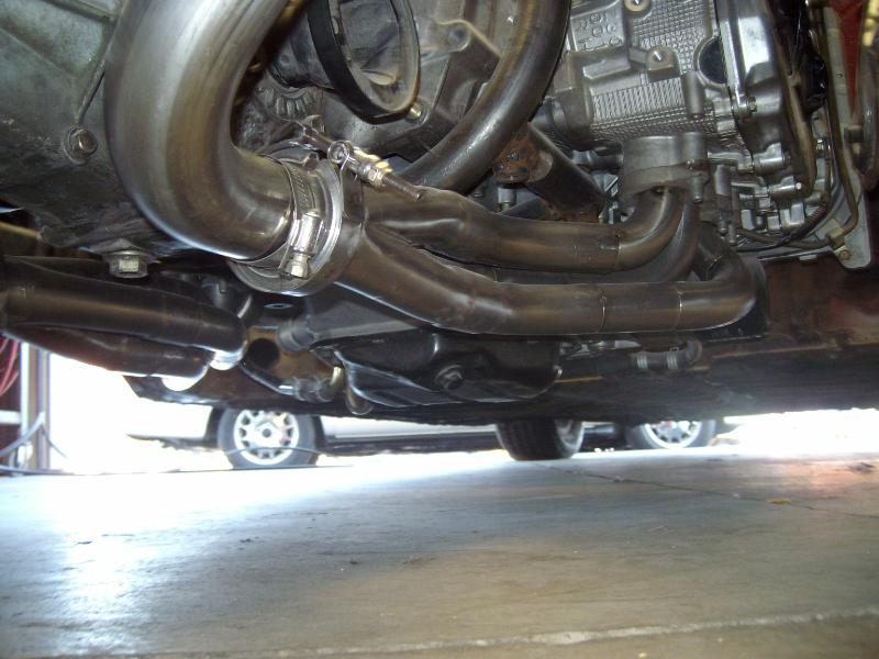

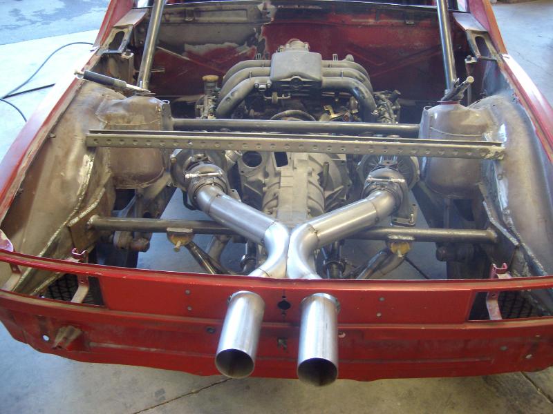

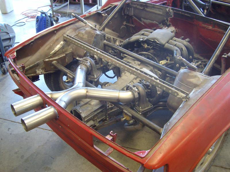

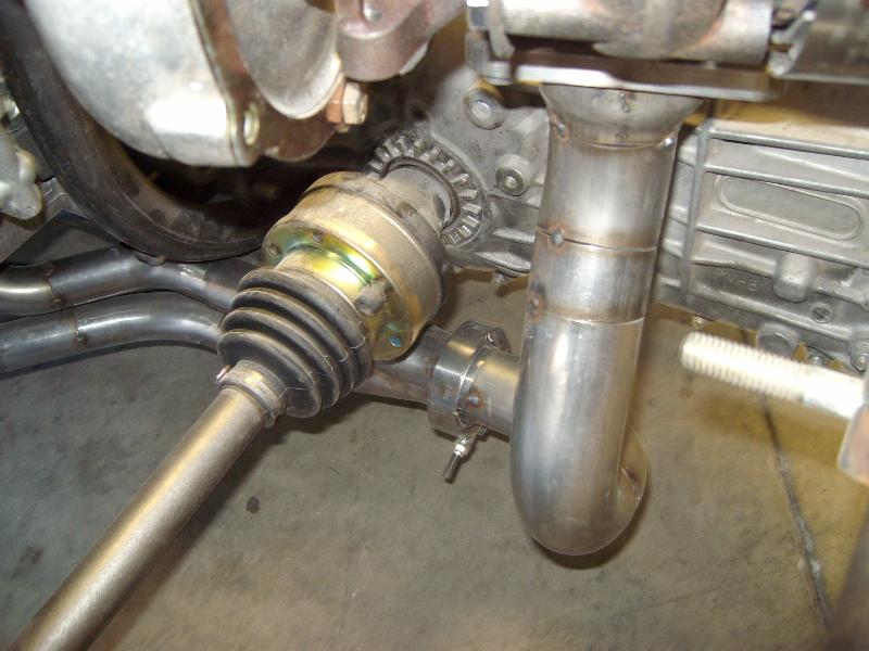

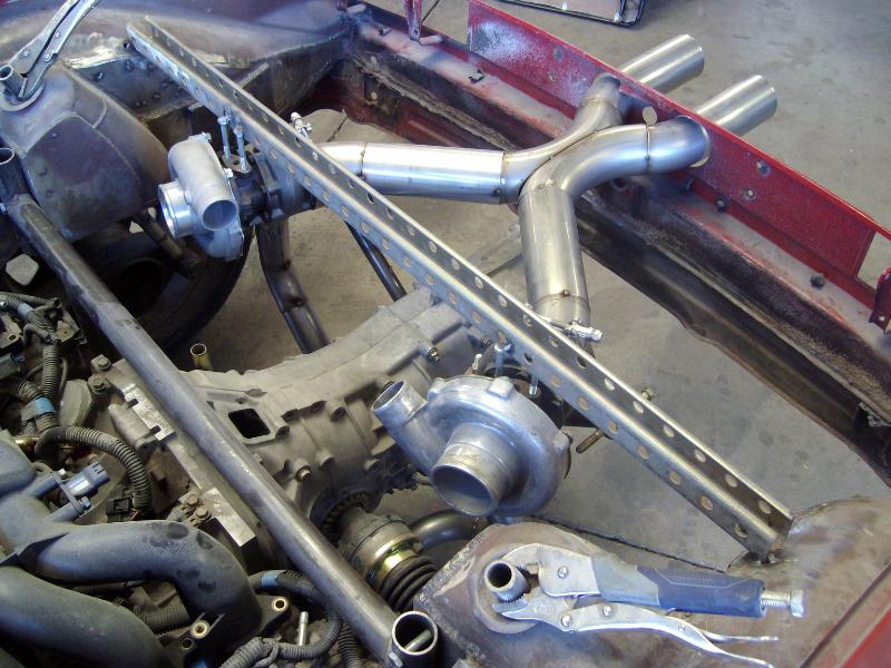

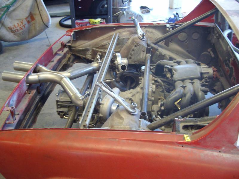

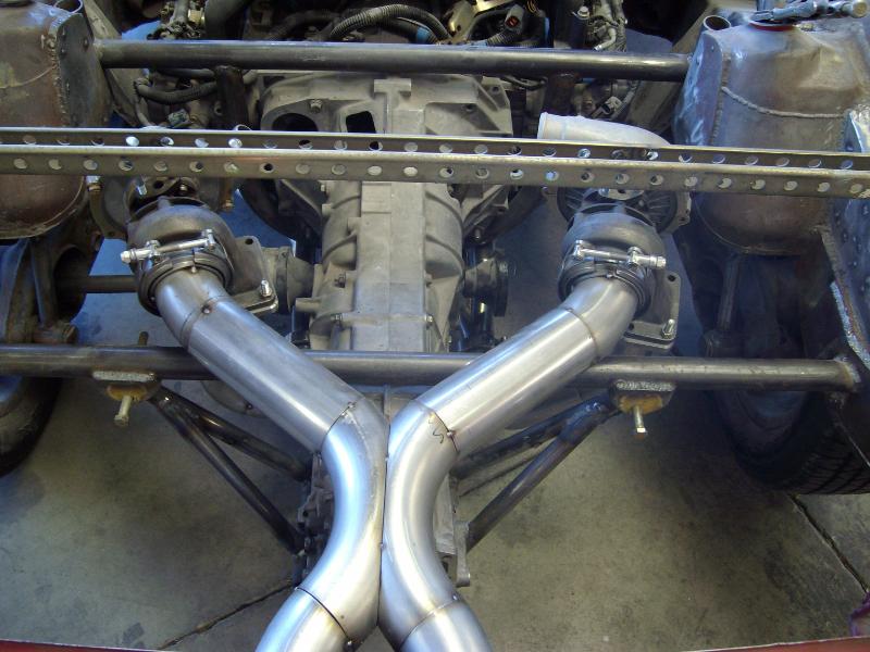

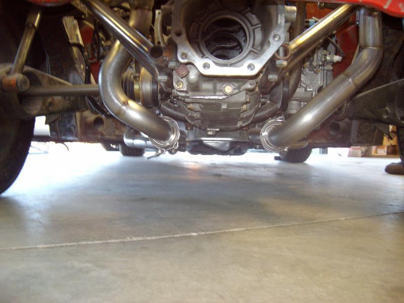

Here's a few pics of all the hot side plumbing tacked together, still have to get the wastegates plumbed though. Hopefully I will get everything final fitted and welded up.
