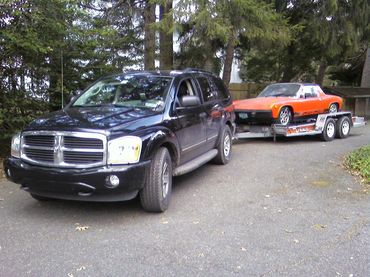

914-6 GT in waiting ![]() ![]() ![]() ![]() ![]() ![]() ![]() ![]() ![]() ![]() ![]() ![]() ![]() ![]() ![]() Group: Members Posts: 20,662 Joined: 19-September 09 From: Landenberg, PA/Wilmington, DE Member No.: 10,825 Region Association: MidAtlantic Region
It’s $50/day to rent a uhaul trailer and 914’s are easy to tow. Buy a mechanical winch on ebay for $20 if your car doesn’t run under it’s own power.
