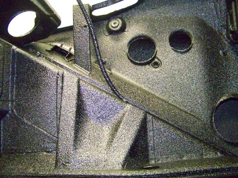

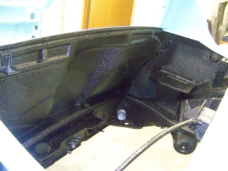

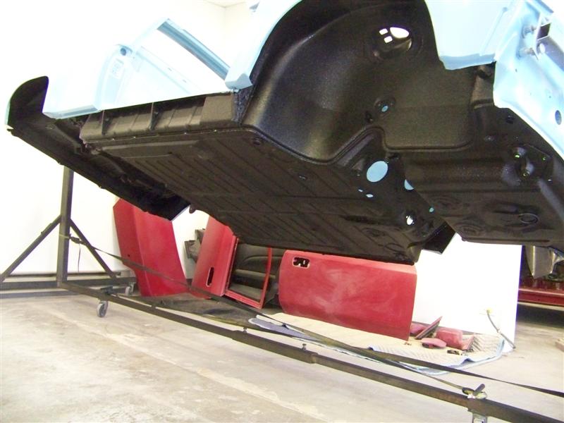

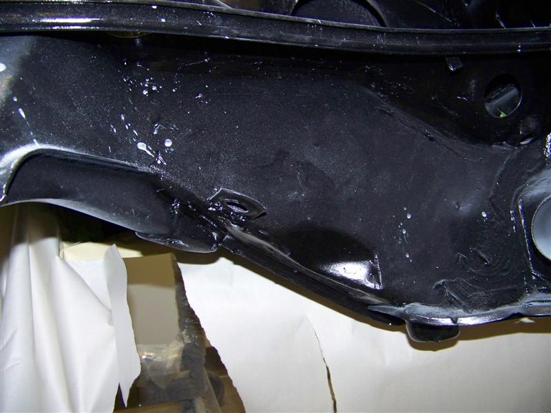

The /4 engine mounts were removed the /6 welded in, and the relay board post cut out The underside and engine bay were coated in the kevlar LineX
