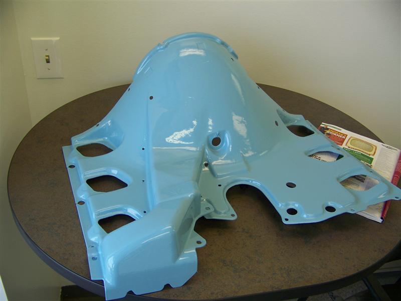

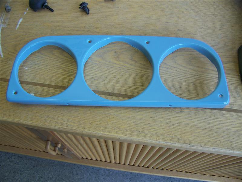

Some odd parts were painted

PanelBilly   Some odd parts were painted   Jun 29 2010, 11:41 PM
