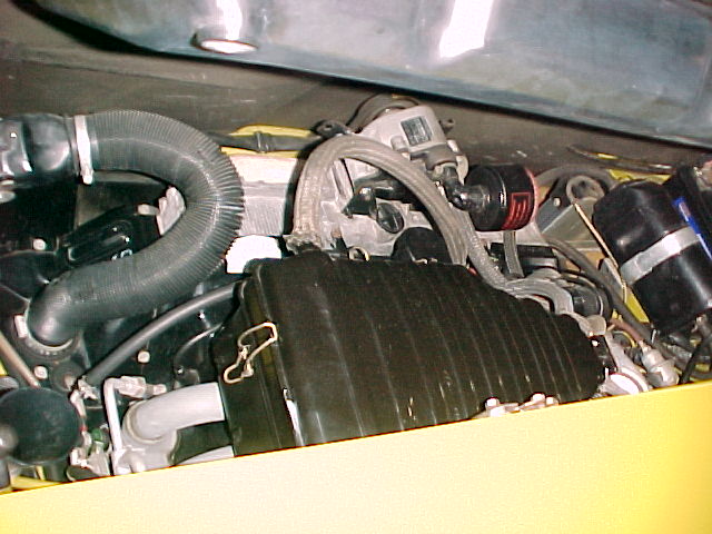

So how does this system work? Review these first two graphics from the factory repair manual to find out.
(PS I wonder why the forced induction guys dont't use the air from the fan housing to spin their turbos? (IMG:style_emoticons/default/confused24.gif))

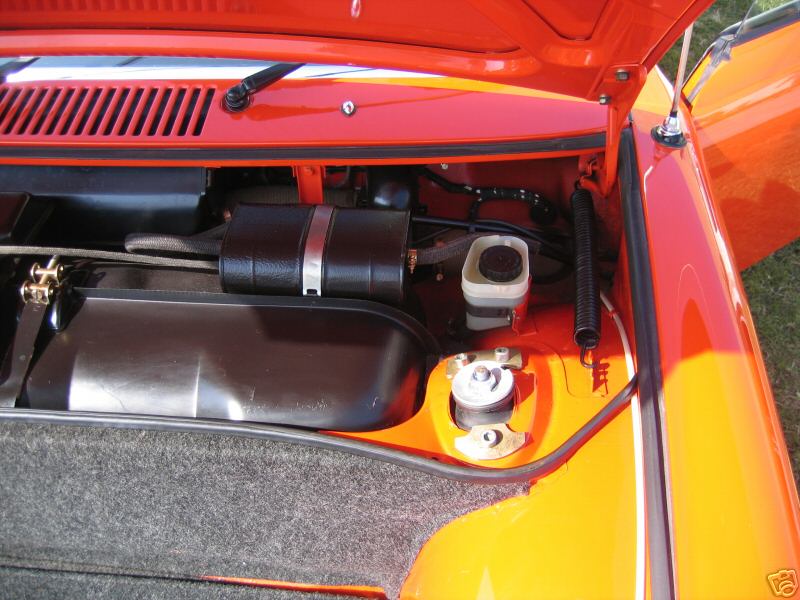

1970 Neun vierzehn   Not all 914s had a charcoal canister. This, from a...   Aug 26 2011, 09:24 PM

1970 Neun vierzehn   the '70/4 is a 49 state car, built date 01/197...   Aug 28 2011, 06:00 PM
