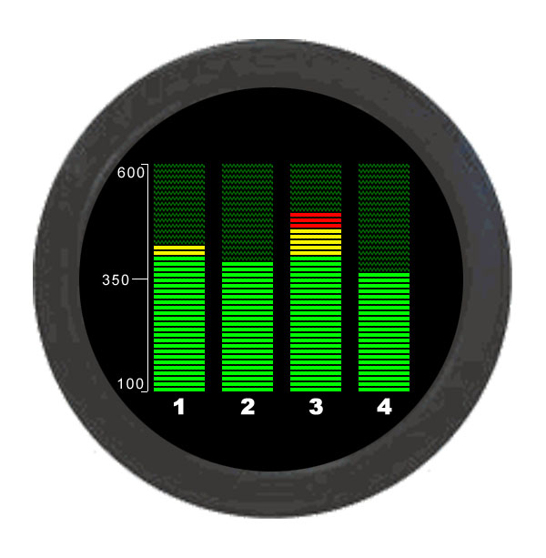

As for the CHT display, i did this gauge mockup a few years back. I still think that would be a cool gauge to build ....
(IMG:style_emoticons/default/popcorn[1].gif) Andy
F-NG cool!!! Your graphic skills rock! (IMG:style_emoticons/default/aktion035.gif)
