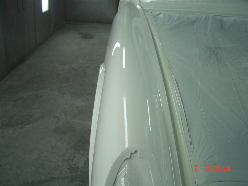

Jim's car was the first real paint job I have done in this booth and all in all it turned out pretty well. I have a little bit of trash to sand out, and I need to reshoot one door because something green fell in the clear, and I don't think it will sand out (IMG:style_emoticons/default/dry.gif) . Then a little reassembly on my part and Jim gets to finish it out (IMG:style_emoticons/default/smile.gif)

type47 In the 4th pic down where there is what looks like... Mar 17 2010, 08:25 AM
Vacca Rabite I love looking at paint tree rings. That was some... Mar 17 2010, 08:36 AM
