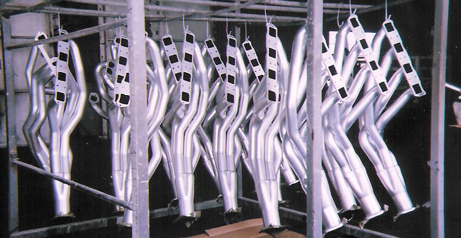

Attached ImageMSDS inc. uses a local metallic ceramic contractor with great success rate on the QC and life of the coatings. Thoroughly blasted, heated, coated (inside and outside), heated once again, cured and then burnished for that awesome satin silver look. All of this for approx 1/2 the price of jethot. Call me at 818-507-6937 or PM for a quote on your system...sorry I can't do rusted thru or 18 gauge exhaust systems (most off-shore types)...just too thin (IMG:style_emoticons/default/mad.gif)
