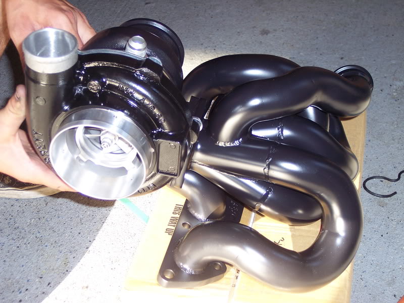

dropped my brand new exhaust off to the local powdercoater Tue Morning. biggrin.gif I will have the before and after picture shortly.
ONTHEGRIND
Sandblast
IPB Image
Base coat and turbo x inside3 and out
IPB Image
Bake
IPB Image
Enjoy
IPB Image
