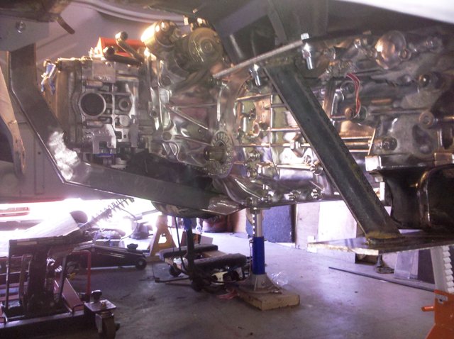

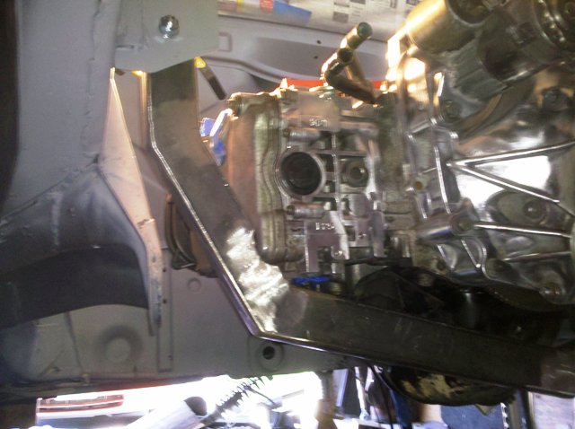

Alrighty then!
More progress on the Suby Transmission mount and the final placement of the mounting tabs for the engine cradle.
I copied the engine cradle/yoke design from Geoff (Strawman)
Another pic with the trans mount
The little notch is my mismeasurement of the cylinder clearance on that side. Should not hurt the stabilty of the cradle.
