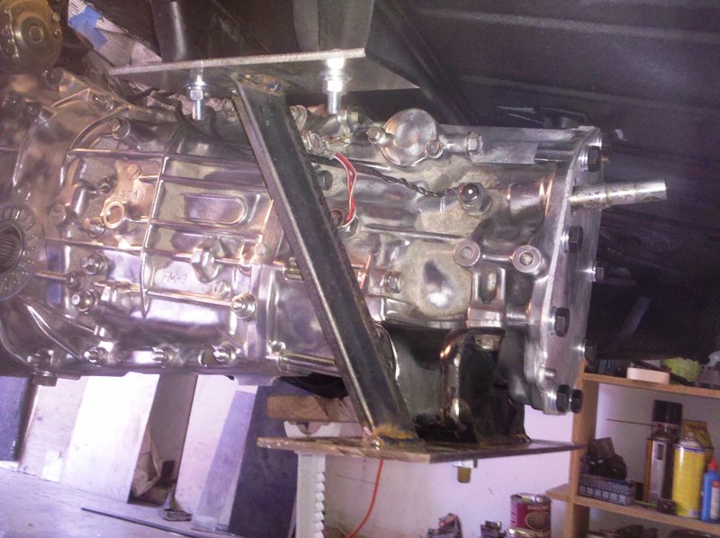

Here is my attempt at the Suby Transmission mount in the 914.
I utilized the stock subaru transmission mount and made a simple plate-based mount to hang from the 914 stock trans mount position.
I will use better fasteners for the final installation. (IMG:style_emoticons/default/driving.gif)

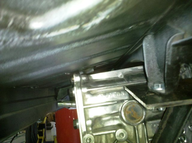

Here is the clearance under the rear trunk. Since this picture was taken I ground down the old muffler hanger tabs. So, there is about 1/2 to 3/4 inch clearance.
