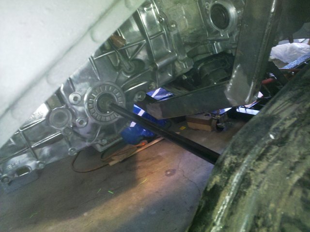

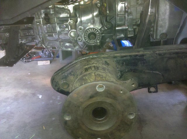

Here is the alignment of the axle for the Suby Trans and the teener trailing arm.

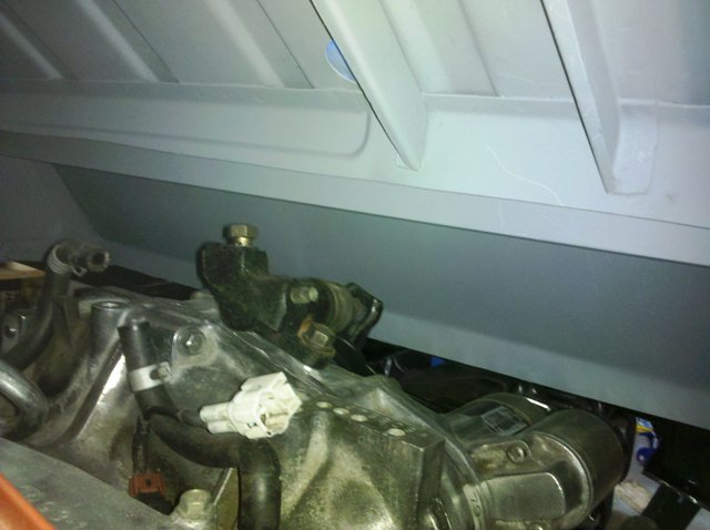

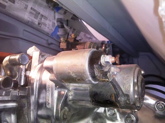

Here is the room from the trunk clearance modification for the starter and the slave clutch cylinder. (IMG:style_emoticons/default/sawzall-smiley.gif)
