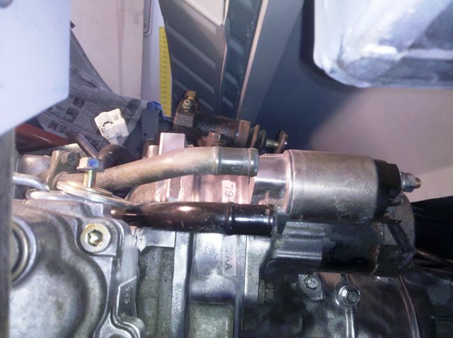

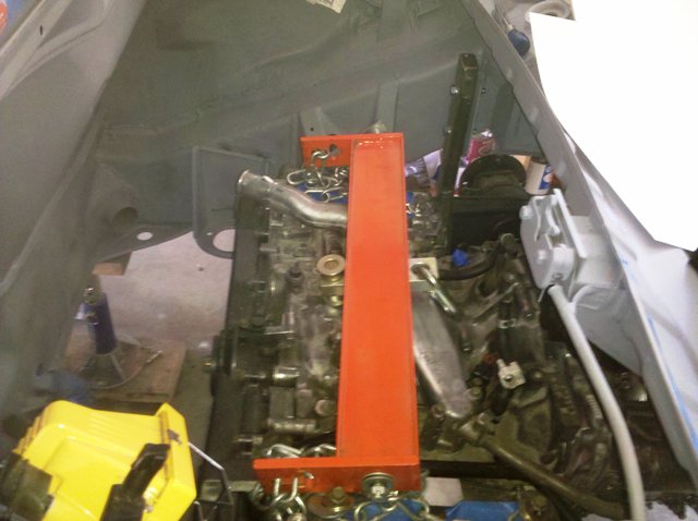

Zaney   Alrighty then! More progress on the Suby Trans...   Jul 20 2010, 01:57 PM
Zaney   Here is my attempt at the Suby Transmission mount ...   Jul 20 2010, 02:04 PM
Zaney   Here is the alignment of the axle for the Suby Tra...   Jul 20 2010, 02:09 PM
Zaney   There is plenty of room in the engine bay with thi...   Jul 20 2010, 02:13 PM
