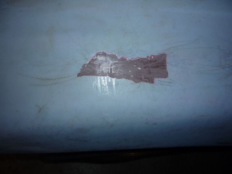

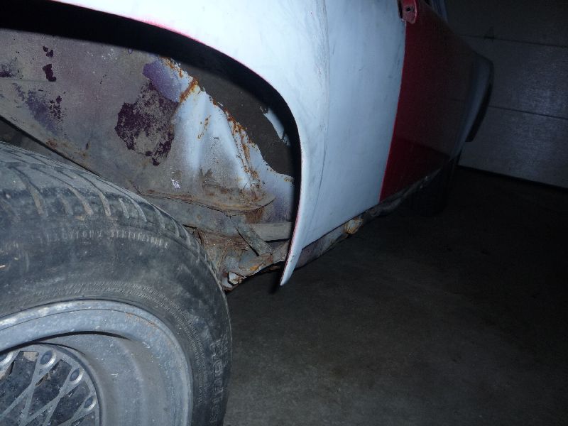

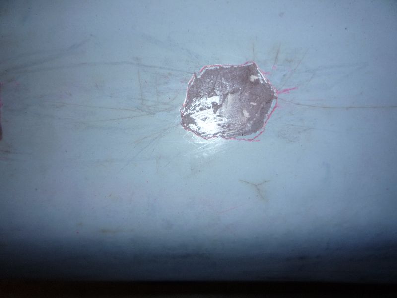

The rear flares has some cracking on the topside. I thought maybe the fiberglass was a little weaker on the one side as the lip was shaved. Seemed lik eit had a fair amount of flex to it. After comparing it to the other side I don't think it's any worse flex wise.
1st question is what is the best product to use for filler on the cracks?
2nd how much of the current filler do I need to take off?

JRust   The rear flares has some cracking on the topside. ...   Jul 20 2010, 10:37 PM
Eric_Shea   A welder. :D Seriously, I'd take it all of...   Jul 21 2010, 08:33 AM
scotty b   A welder. :D Seriously, I'd take it all o...   Jul 21 2010, 02:00 PM
Root_Werks   Yup, sand out the cracks, build a layer or two fro...   Jul 21 2010, 09:23 AM
JRust   Yup, sand out the cracks, build a layer or two fr...   Jul 21 2010, 10:18 PM
charliew   The fg needs to be sanded down to the gelcoat to s...   Jul 21 2010, 09:33 PM
