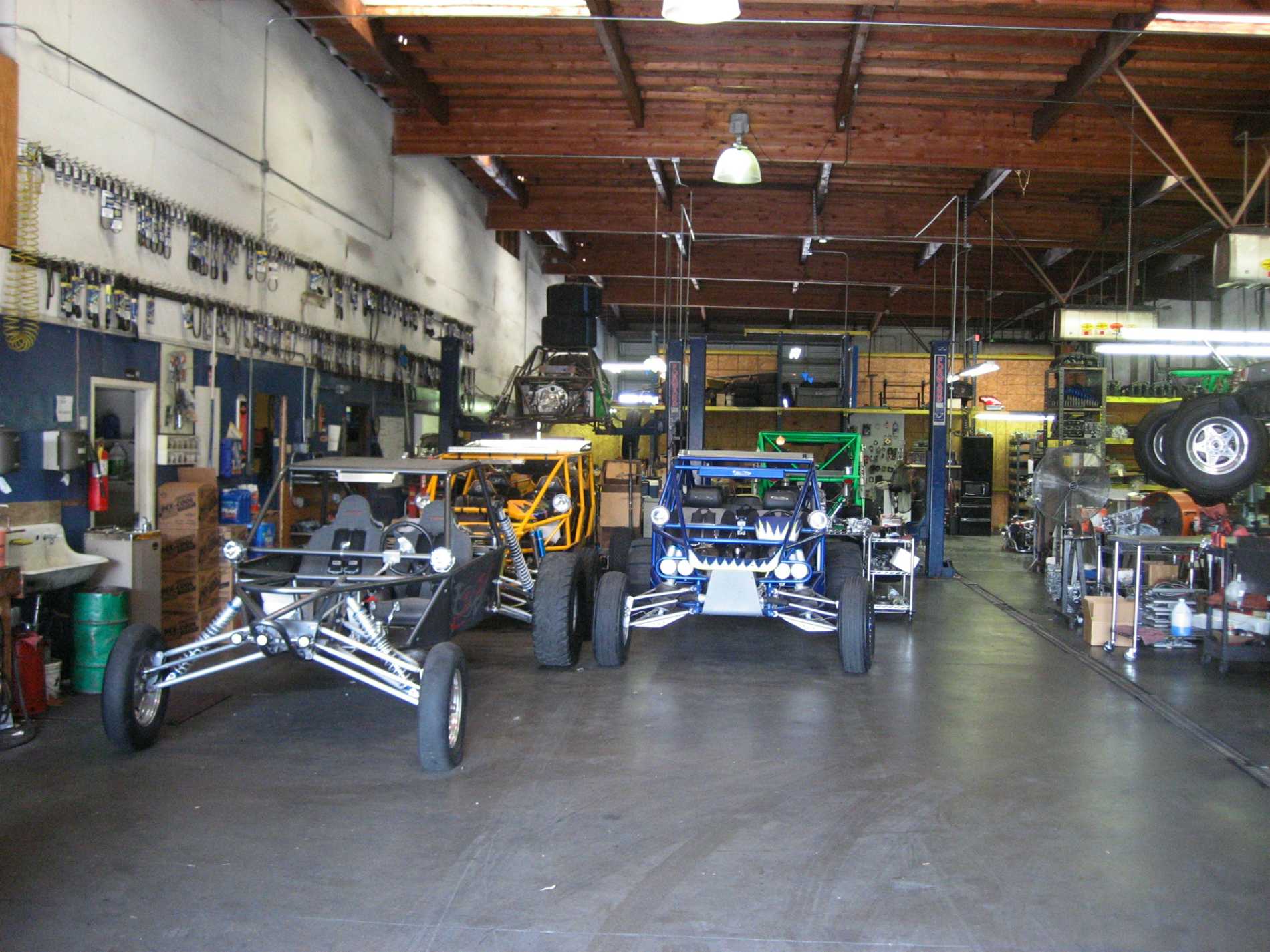

malaga_red75   so, a little update. My 'missing a little pow...   Jul 27 2010, 04:23 PM
malaga_red75   The shop...   Jul 27 2010, 04:26 PM
malaga_red75   My car on the rack in the background. The owner...   Jul 27 2010, 04:28 PM
malaga_red75   Engine building area...   Jul 27 2010, 04:29 PM
malaga_red75   my car on the rack..   Jul 27 2010, 04:30 PM
malaga_red75   the shop...   Jul 27 2010, 04:32 PM
