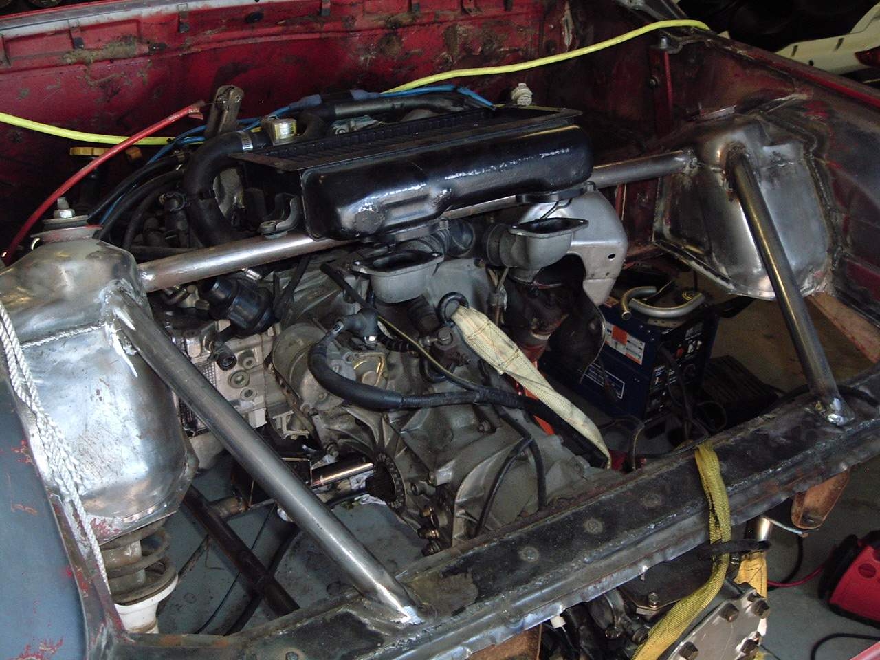

i have a subaru conversion so option "C". Its not done yet haven't quite figured out what i want to do with the intercooler and the oilcooler yet. I own an MR2 so thats where the sidemount intercooler ideas are coming from. thats why i got excited when i saw your scoops. (IMG:style_emoticons/default/cheer.gif)
maybe i could get you to post up a few more pictures? i work at a place that builds composite aircraft so i can get one of the guys to help me make my own molds.(i'm an aircraft mechanic)

well as far as the airflow through the engine bay that all depends on what i do with the intercooler set up. i was thinking of a sidemount if i do that the air will have to exit the engine bay lid. if i go with a stock type intercooler (air to air behind the engine over the trans) i was going to have it vent out the rear deck lid(i don't have a trunk anymore). option c was an air to water with the exchanger either side mount or all the way back up to the front trunk. then the engine bay would agian just have to exit the engine lid.
as far as the radiator its in the front trunk its gooing to exit the hood ala gt40 style. i have a friend that tells me we can make hood louvers from composites as well. that might be pretty trick if they flow the lines of the triangular hood suppport.
i'm still in the early stages of my build so i havent got everything figured out yet.
i didnt like the idea of venting under the car either all thou it seems to work well on my mr2.
as luck has it i came across an oil to water cooler in the trash it was left
over from an R&D project at work the other day. if i can get that plumbed into my hard lines going up front that would be the ultimate setup. very minimal pressure/flow loss no need for an oil t-stat. very clean install.
as far as skills with composites mine are really only based in airframe repair. im not so skilled in fabwork. but i have a few friends in the production side of life that owe me favors. if it burns fuel i can fix it/ build it/ make it better. if it involves fabwork/ bodywork i get by with a little help from my friends.
i appreciate you sharing yourscoop pics with me. i have been kicking around a few ideas then i ran into yours and those look very clean/trick on the 914 almost factory race style.
