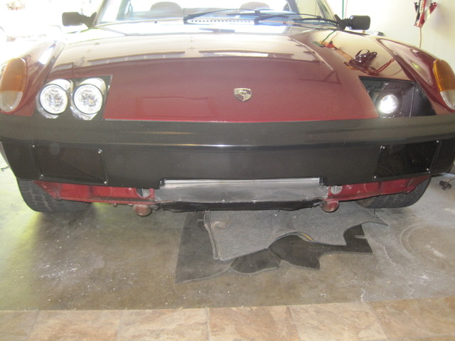

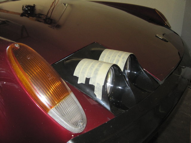

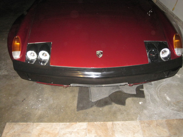

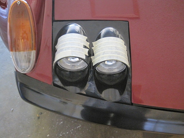

I saw a member from Purto Rico use these. I thought I would give it a try. They are for a Nissan 240SX. After 40 hours of cutting and fiberglass, (IMG:style_emoticons/default/sawzall-smiley.gif) they fit pretty well. I will fix the gaps and do some clean up after I strip the body for paint. Fender lines are not straight due to bondo. The slant angle is extreemly close to the 914. (IMG:style_emoticons/default/smilie_pokal.gif) Each lamp can be adjusted up/down and side to side.
Specs: H7 lamps, LED halo (white/blue color) comes with wire harness with relay for high beam (high beams illuminate all 4 lamps)
If you want to do this too, I recommend a cardboard template of the stock lamp covers. There are no right angles on the 914 headlamps. the template will be smaller than the overall size of the 240sx assembly. find a good fit and cut larger than your marks. Trip and shape slowly. once you have your shape, reinforce the bottom with fiberglass (Kitty Hair and gel). I then mounted some L brackets to the factory mounting holes. I set some wet glass to the brackets and "glued" the assembly in place. Rivet nuts on the brackets make removing easy. Use large washers and open up the factory holes to make final adjustment easy.

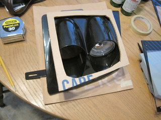

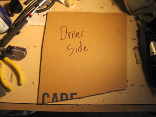

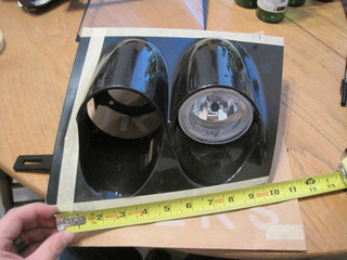

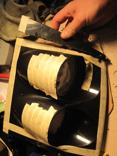

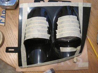

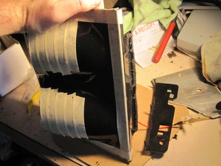

Ok....so this job is not easy. Took about 4 hours to tape off and cut last night.
Here are some photos of the process:
Carboard cut-out
(IMG:http://www.914world.com/bbs2/uploads_offsite/img844.imageshack.us-11125-1280430059.1.jpg)
Use to mark cut location.
(IMG:http://www.914world.com/bbs2/uploads_offsite/img339.imageshack.us-11125-1280430059.2.jpg)
Tape it out
(IMG:http://www.914world.com/bbs2/uploads_offsite/img835.imageshack.us-11125-1280430059.3.jpg)
Measure
(IMG:http://www.914world.com/bbs2/uploads_offsite/img94.imageshack.us-11125-1280430059.4.jpg)
The hard part.....cutting.
(IMG:http://www.914world.com/bbs2/uploads_offsite/img194.imageshack.us-11125-1280430059.5.jpg)
Cut off nissan mounting plastic
(IMG:http://www.914world.com/bbs2/uploads_offsite/img838.imageshack.us-11125-1280430060.6.jpg)
Lots of trimming and marking and sanding and trimming (time consuming)
(IMG:http://www.914world.com/bbs2/uploads_offsite/img819.imageshack.us-11125-1280430060.7.jpg)
Not bad for a first cut & fit
(IMG:http://www.914world.com/bbs2/uploads_offsite/img210.imageshack.us-11125-1280430060.8.jpg)
Old headlight vs new
(IMG:http://www.914world.com/bbs2/uploads_offsite/img217.imageshack.us-11125-1280430061.9.jpg)
Now it's time to go to bed, perfecting fit & painting & retrofit HID projector after sleep:
(IMG:http://www.914world.com/bbs2/uploads_offsite/img375.imageshack.us-11125-1280430061.10.jpg)
