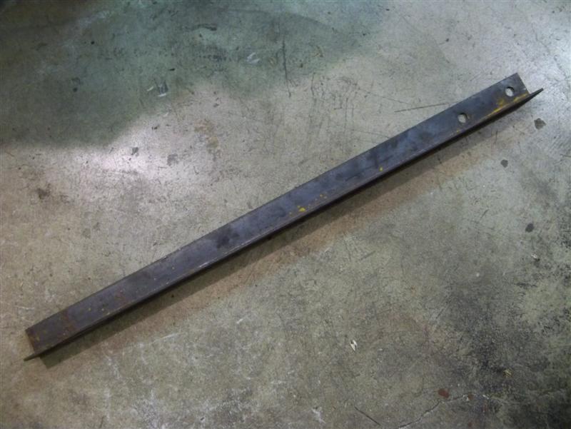

Here is one that is surprisingly simple but I find I use it the most
It bolts to the rear hubs w/o wheel using the stock lugs & prevents
turning even when busting off then stub nut. (IMG:style_emoticons/default/aktion035.gif)
