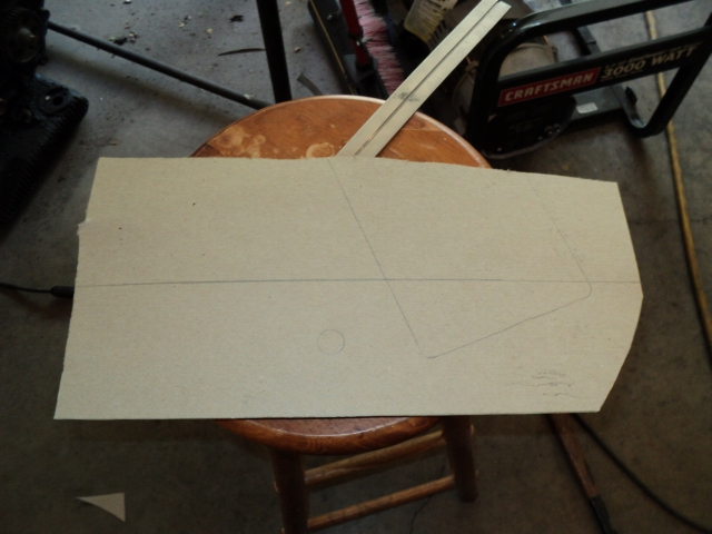

Did some fabrication today. This is a part that is not available so I had to make one. You think our 914 rust...
Here's a tip for you all. I go to the local small town print shop and buy this card board. It's the backing for desk top calendars. It's the perfect pattern board and it's cheap.

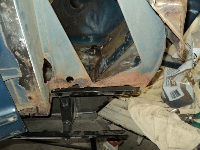

rick 918-S   Did some fabrication today. This is a part that is...   Jul 31 2010, 07:39 PM
rick 918-S   Part of this repair involves repairing a speaker h...   Jul 31 2010, 07:39 PM
rick 918-S   Adding a factory hole from the pattern. Notice the...   Jul 31 2010, 07:51 PM
rick 918-S   Fitting the new panel. It lines up nice. Notice th...   Jul 31 2010, 07:55 PM
rick 918-S   New lower cowl section. Speaker hole mostly rep...   Jul 31 2010, 07:59 PM
rick 918-S   One more. Repair panel welded and ground.   Jul 31 2010, 08:05 PM
