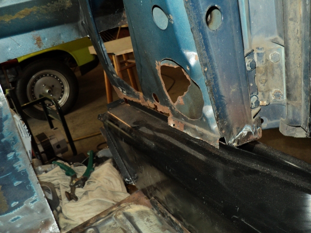

Part of this repair involves repairing a speaker hole someone hacked into the door post. It isn't bad enough that the car was rusted nearly half way up the sides this hole kills the strength of the post big time.

rick 918-S   Did some fabrication today. This is a part that is...   Jul 31 2010, 07:39 PM
rick 918-S   Part of this repair involves repairing a speaker h...   Jul 31 2010, 07:39 PM
rick 918-S   Adding a factory hole from the pattern. Notice the...   Jul 31 2010, 07:51 PM
rick 918-S   Fitting the new panel. It lines up nice. Notice th...   Jul 31 2010, 07:55 PM
rick 918-S   New lower cowl section. Speaker hole mostly rep...   Jul 31 2010, 07:59 PM
rick 918-S   One more. Repair panel welded and ground.   Jul 31 2010, 08:05 PM
