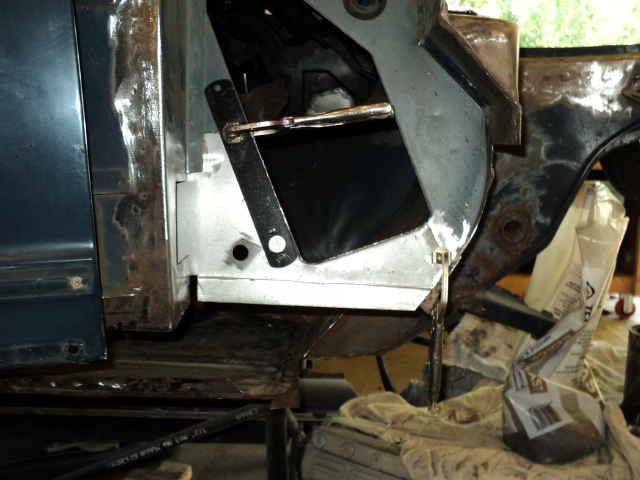

Fitting the new panel. It lines up nice. Notice the square cut out on the post. I cleaned up the jagged edges but I still need to patch that. That is from a hole saw from the speaker hack job.

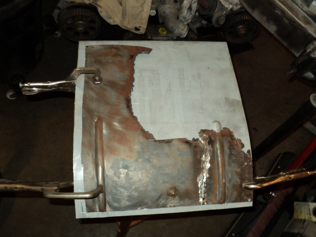

Here's how rusted this car was. This is the lower cowl panel.
