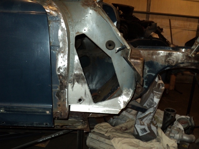

rick 918-S   Did some fabrication today. This is a part that is...   Jul 31 2010, 07:39 PM
rick 918-S   Part of this repair involves repairing a speaker h...   Jul 31 2010, 07:39 PM
rick 918-S   Adding a factory hole from the pattern. Notice the...   Jul 31 2010, 07:51 PM
rick 918-S   Fitting the new panel. It lines up nice. Notice th...   Jul 31 2010, 07:55 PM
rick 918-S   New lower cowl section. Speaker hole mostly rep...   Jul 31 2010, 07:59 PM
rick 918-S   One more. Repair panel welded and ground.   Jul 31 2010, 08:05 PM
